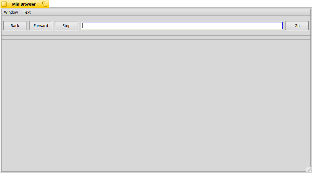

One final thing to know: rather than testing our implementation of WebKit2 with WebPositive, there is a very simple browser called MiniBrowser that we use that was made specifically for this purpose. Most likely, WebPositive would require several APIs that are currently not implemented. The advantage of using MiniBrowser is that it only requires a minimal set of APIs and the code for it is small enough that it can easily be updated if the API is changed.
Screenshot of MiniBrowser. The UI is very stripped-down. It doesn’t even have tabs!

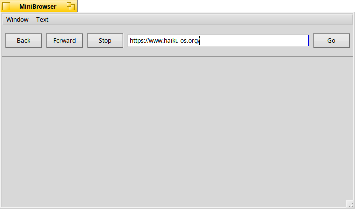

Well, there were no more obvious crashes, but there were no web pages displaying either. MiniBrowser did not make any attempt at drawing them to the screen.
A screenshot of a reproduction of the problem. MiniBrowser was navigated to https://www.haiku-os.org/ but made no attempt at displaying anything. The background stayed gray
Why? Well, some critical functions involved in drawing weren’t being called. But why? Well, after going up the chain for a while, I was finally able to figure out what was going on. It turns out, in some situations, the run loop was failing to process tasks given to it.

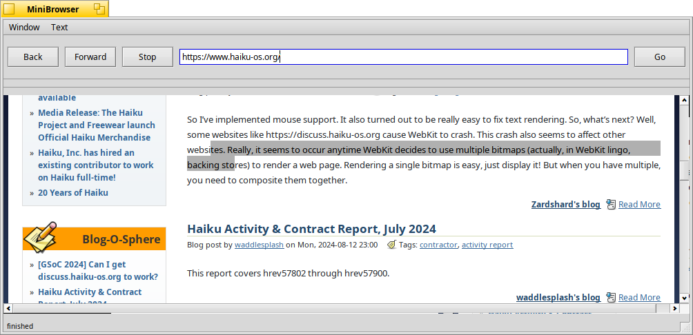

7. Adding mouse support and fixing text rendering
Both of those problems turned out to be very easy to fix. Mouse support required just a routine implementation of a function or two, and I guessed what was preventing text from rendering relatively quickly.
And with that, we had a relatively functional WebKit.
Screenshot of discuss.haiku-os.org. The page is scrolled down and some text is selected. Text is being displayed properly.
