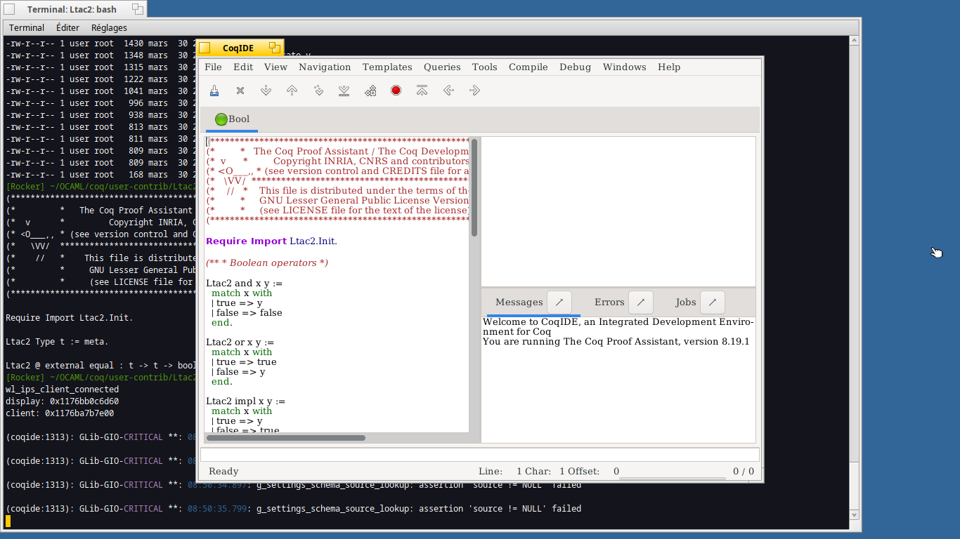

For months or even more than a year, I could not get past this lablgtk3 package, cause Haiku only gets gtksourceview-4
in haikuports/x11-libs/gtksourceview
So I tried to trick lablgtk3 to compile with gtksourceview-3 files symlinked to gtksourceview-4 files, and a bit of renaming 3 <-> 4 here and there.
It worked but coqide
crashed pretty soon when used due to this poor setup.
So I decided to take the other way: port gtksourceview3
properly.
I achieved that last month, the PR is in phase of polishing, but was enough for me to carry on the work further.
