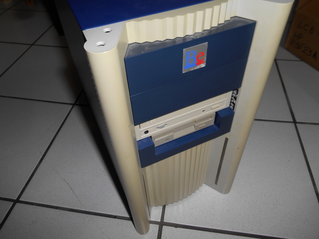

Actually, some time ago, Finn Bastiansen mailed me, asking if I was interested in getting a BeBox he didn't use anymore. He thought about auctioning it first and giving the money to Haiku, Inc. but he thought it'd be interesting to see if it could boot Haiku. It might take some time but should be quite doable.
Unboxing the blue boxUnboxing the blue box It’s a weird feeling opening the thing…
Beeeeee Box!It’s in pretty good condition for such an old lady. The two top plastic caps are left alone, they have broken clips but I should be able to fix that. The gray facade has yellowed a bit, but not too much.

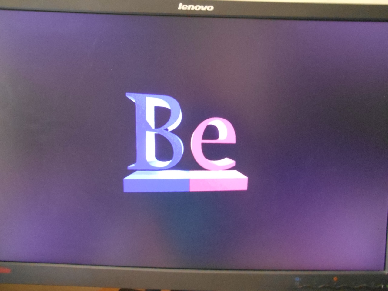

Let’s see how it boots now…
At least it tries to… oh, the harddisk was plugged off! Let’s fix this… much better!
So what’s the CPU already?
sysinfo outputAbout box
