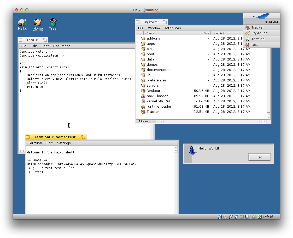

Since the three-quarter term report, I have continued porting userland servers and apps. The app server is fully functional, as are Deskbar and Tracker and a few other apps. I also cross-compiled all of the basic development optional packages (GCC/Binutils, autotools, make, etc.) for x86_64. Another screenshot showing the current state of things is below:
As you can see, this looks pretty much like a regular Haiku desktop. There’s still a lot of things missing, though - not many apps or drivers yet. However, most things should be fairly simple to get working, typically just a few compilation fixes.
