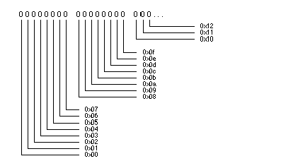

In both cases, the bitfield is an array of 16 bytes,
uint8 states[16];
with one bit standing for each key on the keyboard. Bits are numbered from left to right, beginning with the first byte in the array, as illustrated below:
Info Icon
Bit numbers start with 0 and match key codes. For example, bit 0x3c corresponds to the a key, 0x3d to the s key, 0x3e to the d key, and so on. The first bit is 0x00, which doesn't correspond to any key. The first meaningful bit is 0x01, which corresponds to the Escape key.
