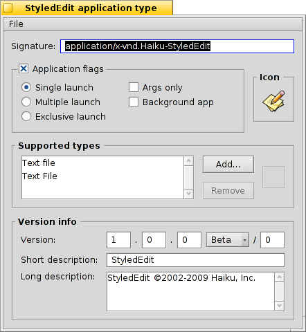

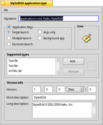

index Special settings for applications
If you invoke the Filetype add-on on an executable (here: StyledEdit), you'll get a different dialog:
On top, you'll see, instead of a standardized MIME string, the unique application signature. With it, the system finds the program wherever it's installed.
Below it are several flags, controlling the app's behaviour:
Single launch Only one instance of the app can be running per executable file. If you have two copies of that app, however, they can run side by side.
Multiple launch Many instances of the app can run simultaneously.
Exclusive launch Really only one instance with that app's signature is allowed to run at a time.
Args only Indicates the app doesn't respond to messages.
Background app The app won't appear in Twitcher or the list of running apps of the Deskbar.
Then there's the list of supported filetypes. You can add (and remove) filetypes if you think the application can handle them. As a consequence, the app will appear in the menu for preferred applications or Tracker's Open with… context menu when you right-click on a file of that type.
At the bottom are version and copyright information. Like the application signature, they are filled in by the app's author and shouldn't be altered.
